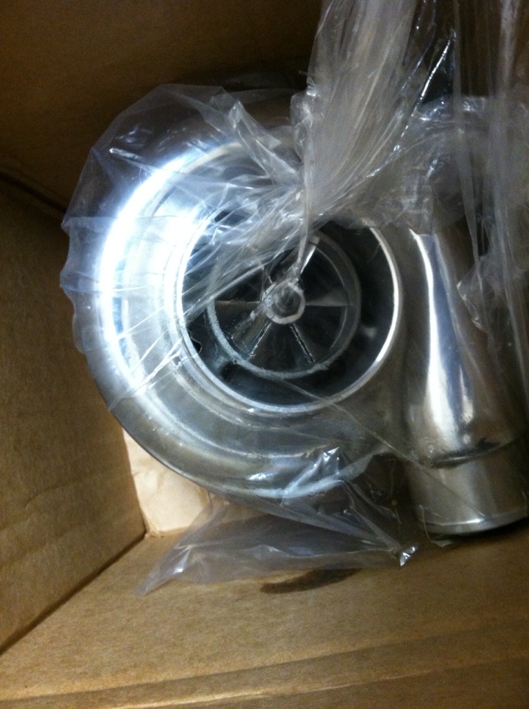

Got the turbo in today!
Sent from my Motorola razr (flip phone)
