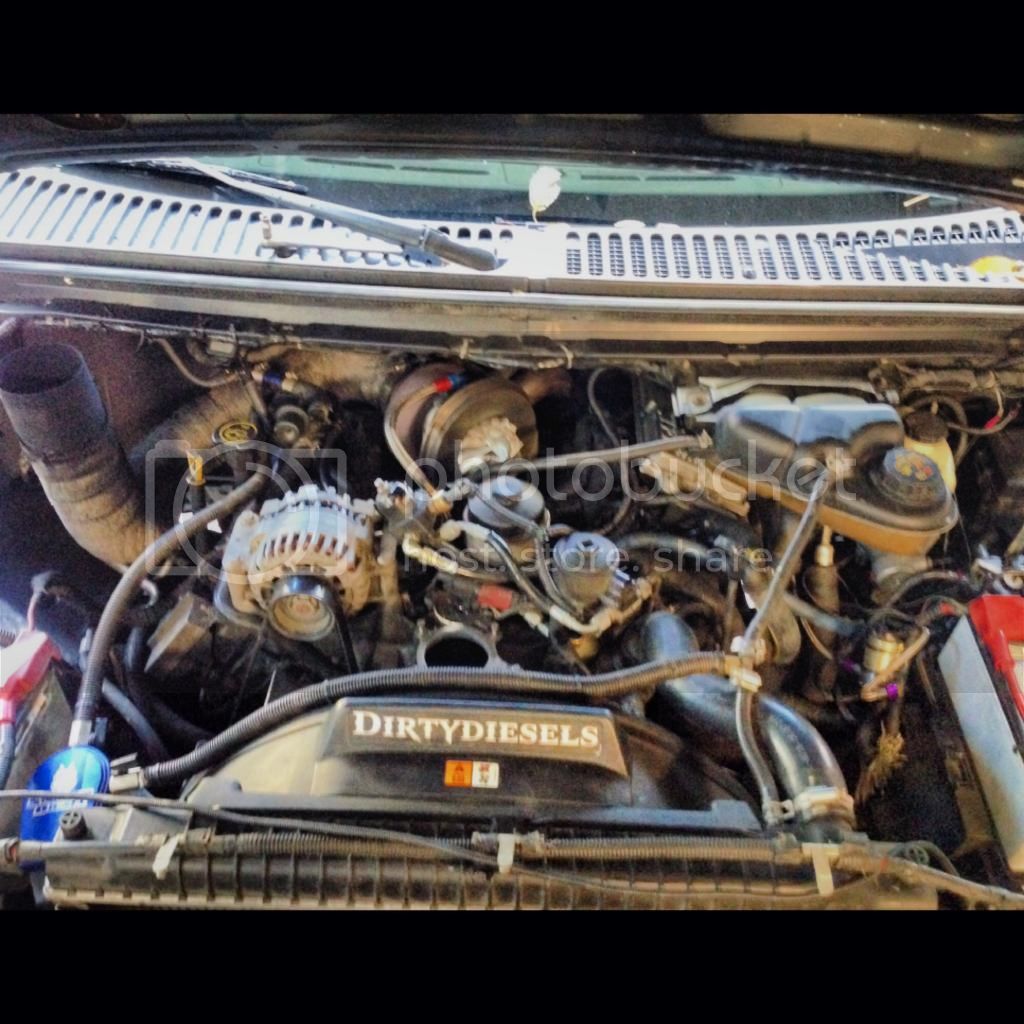

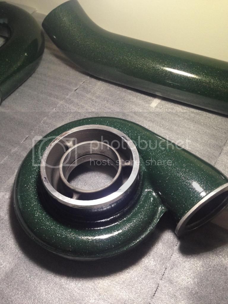

Decided to do a bit of under hood cleanup and wire looming while the truck is apart... also sent some stuff out for some color :)
Josh@DirtyDiesels
Dec 3, 2011
4,949
PA
Think my next major under the hood thing is going to be moving the batteries to the bed and where the heater box was I'm going to do a "box" that will have power terminals on/in it and will also be home to a nitrous solenoid or two :)
