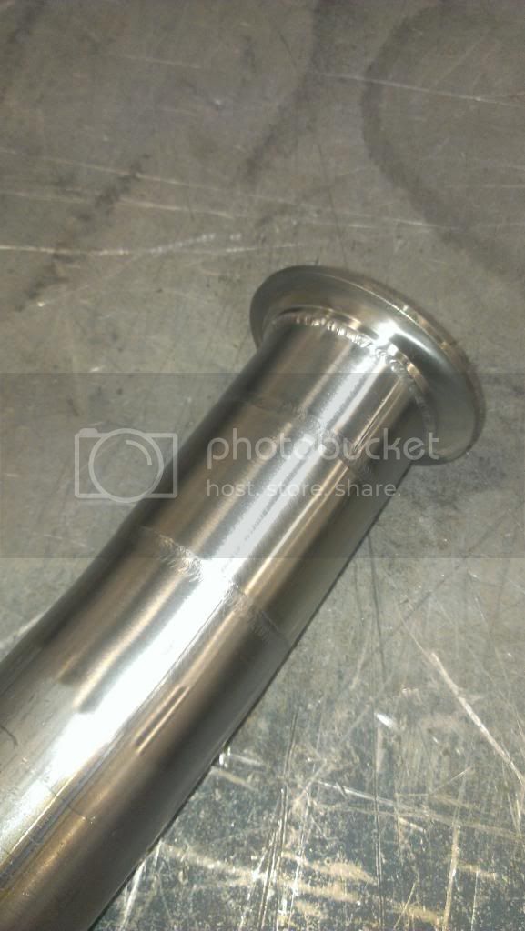

:fustrate:I went to install the hot side pipe this morning and when installed, there is a 2.5'' gap between the top side v band and the bottom side v band. I tried everything possible and there is just not enough pipe there to make it work. Looks like I will have to cut the pipe where it is coming down to the intercooler and add 2.5'' of pipe on there so it will work. Has anyone else had this experience or is it just my issue? I left it loose, tried to fit it with no better results. Bottom line is that it needs to be extended to work.
Also my downpipe had to be cut at a angle for the correct fitment. It was tight on the bottom when I tried to put the pipe in but had a 1/4'' gap on the top. Not a big deal but I just don't have time during the week to do this stuff and nobody is open on the weekend.

thats really strange! the bends are all the same. maybe nathaniel was drinking when he welded it. if you do it yourself, make sure you retain the bead rolled end. sorry to hear buddy !!

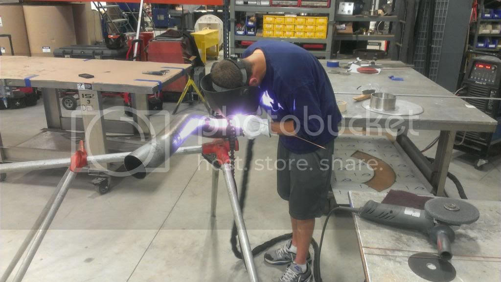

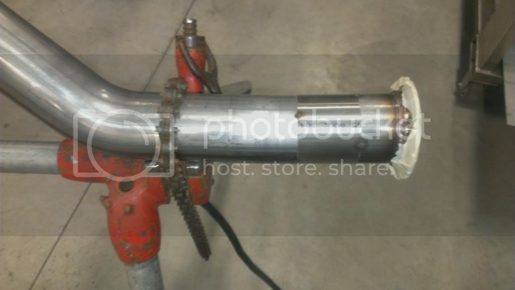

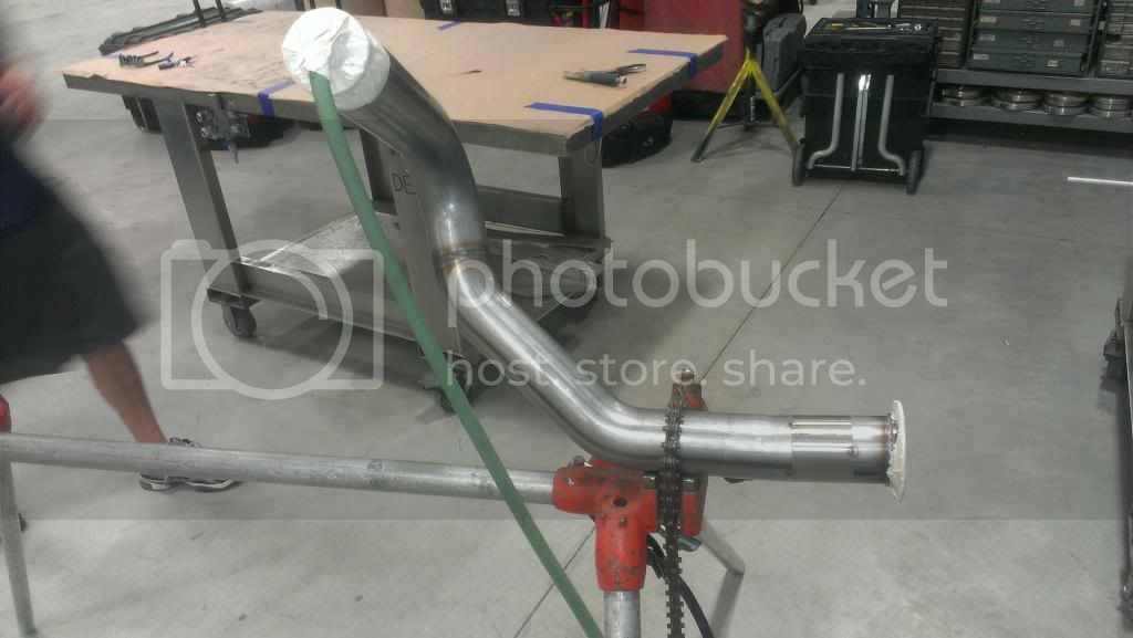

I will have to have someone do it for me as I have no idea how to weld stainless. It will be cut above the v-band on the pipe that is connected to the high pressure turbo and then the 2.5'' pipe added and the original peace put back on.

Looks like I will be meeting up with the owner of Beyond Redline tommarow and giving him the pipe to fix. He says he will probably get to it Monday. That means that I probably wont have the truck going until next weekend now.

I am 100% sure about that. I removed everything around the high pressure turbo to be sure of that as well. It is perfectly mated to the turbo. The pipe just isn't long enough to meet up with the bottom side v-band when its put into the intercooler. I put a tape measure between the two v-bands and its exactly 2.75" gap between the two. The top side pipe currently does not come below the power steering pump even. That cannot be correct because how would you ever get the v-band up there and get it tight. I talked to a few guys and they had to extend their top side pipe as well to fit. Seems like it is common.

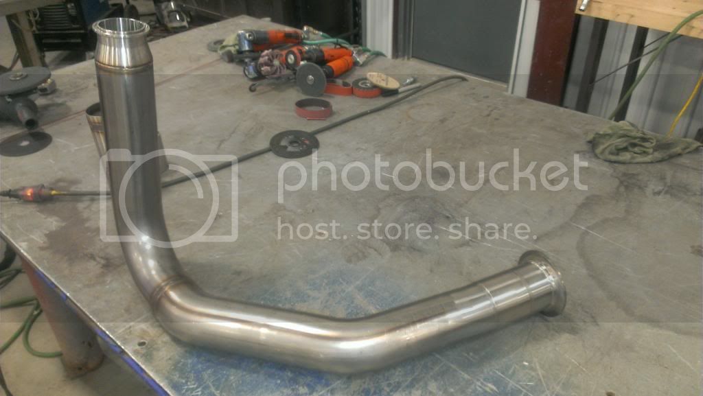

Here is what my night consisted of. Fixing my downpipe to fit as well as fixing the hot side pipe to fit correctly.

Tommarow we will be polishing all the pipes before they go on the truck as well. It is great to have connections close to home.
