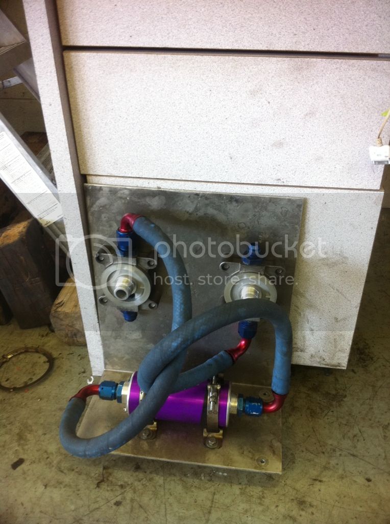

Hope it works out for you bud, that fits right in between the tank and the t case, goes right onto the metal skid on the front of the tank.
Left side is fuel water, right side is regular fuel. Has the pump set on low speed already.

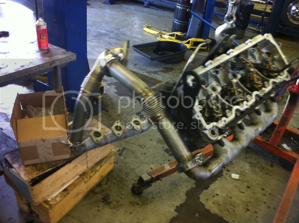

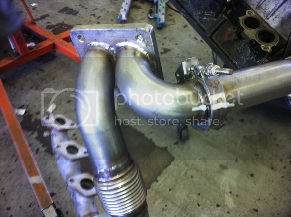

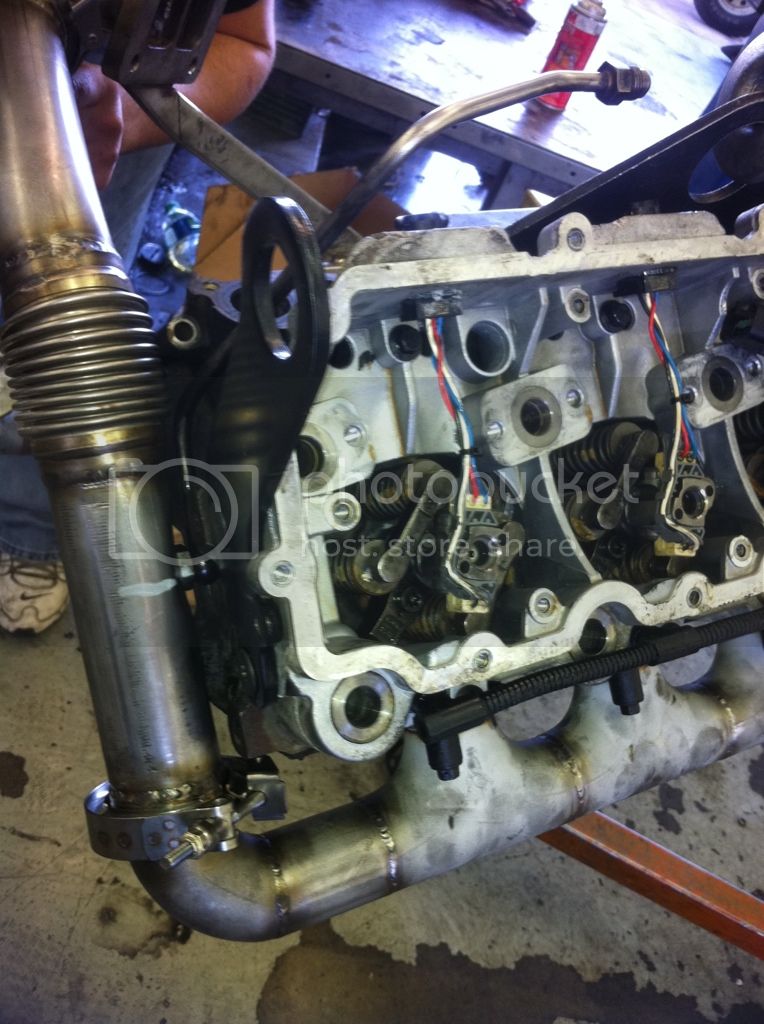

this is how i had to make the rh up pipe fit with my regulated return banjo bolts i had to do a lil custom work on my mpd set up
another view
just getting an idea how its set up

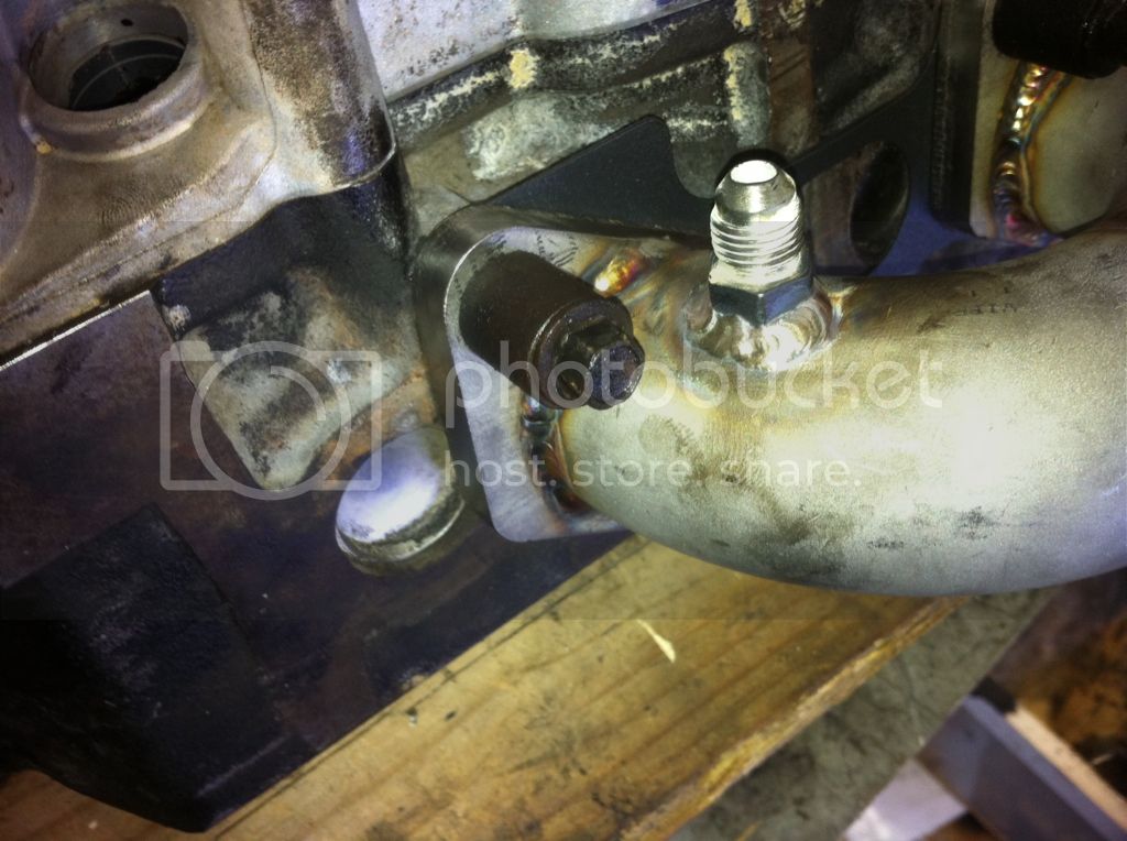

welded my ebp adaptor in the stock location
tapped my hole for egt probe. look at the bottom right bolt it was a tat t close to pipe had to toruqe it with crows foot

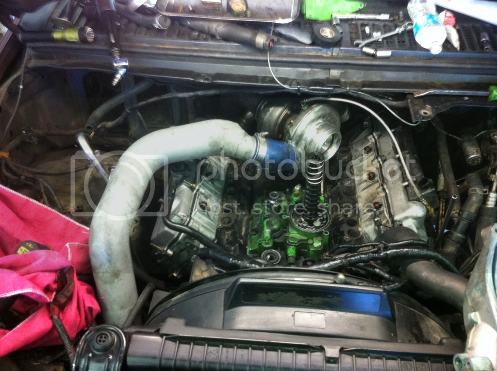

this is the way i ran my oil return my egr delete kept getting in the way to run it the MPD way
checking clocking of compressor housing
if you have big hands i ADVISE to install turbo with intake off it helps a ton
