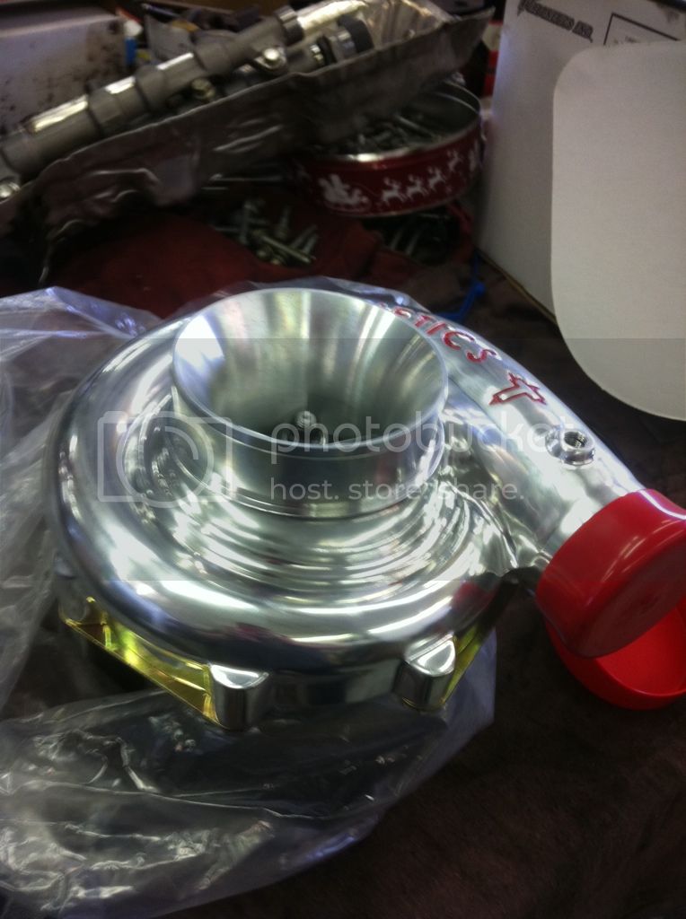

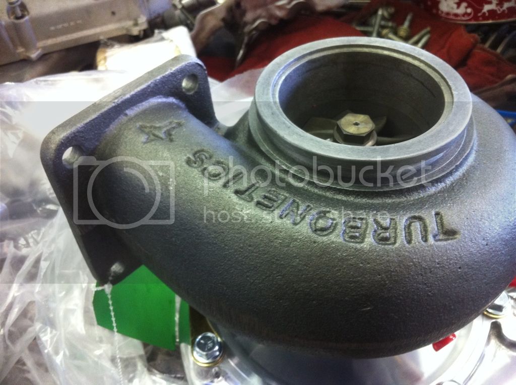

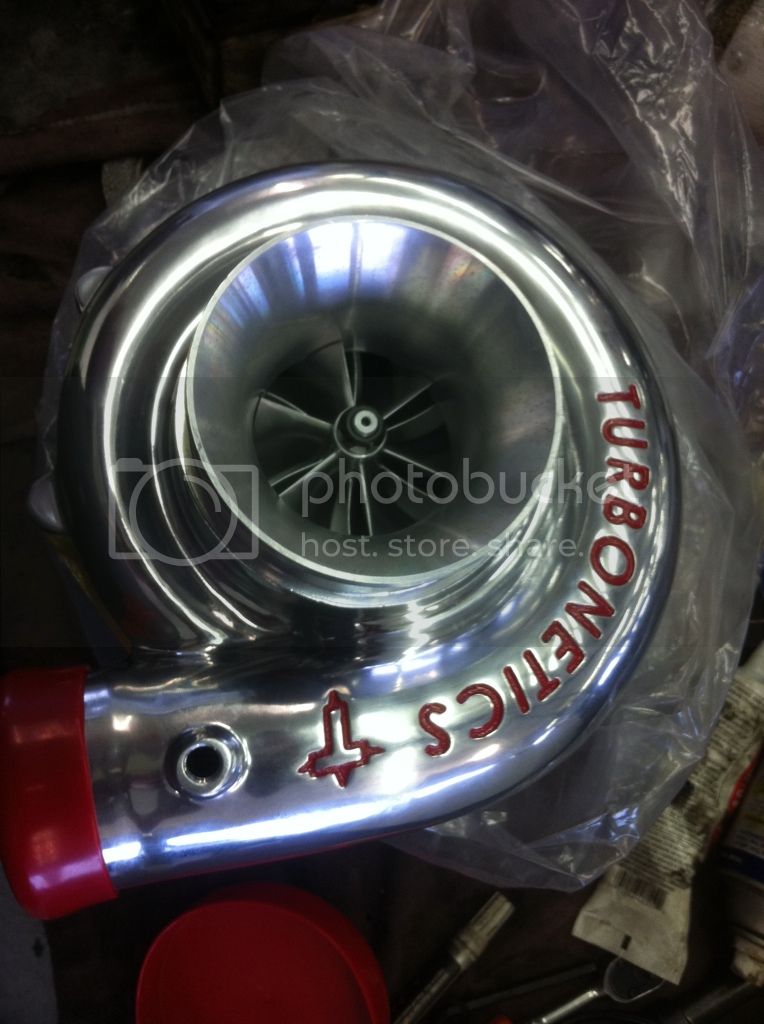

Got new turbo in from Kem performance
Still waiting on some more parts to come in.

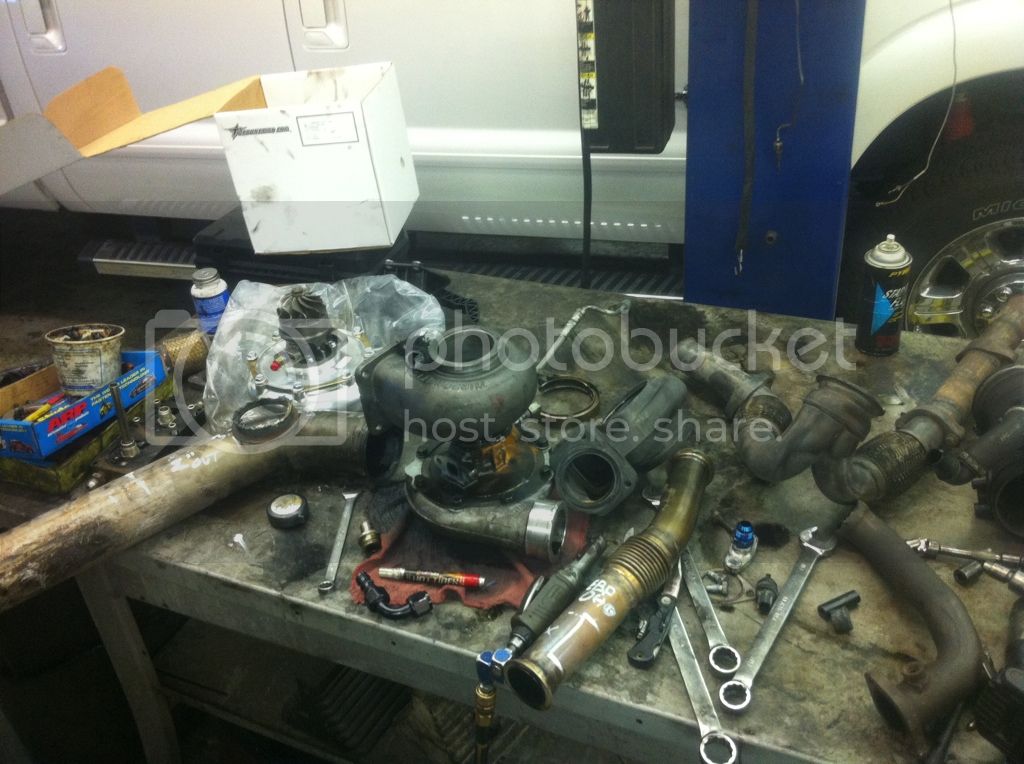

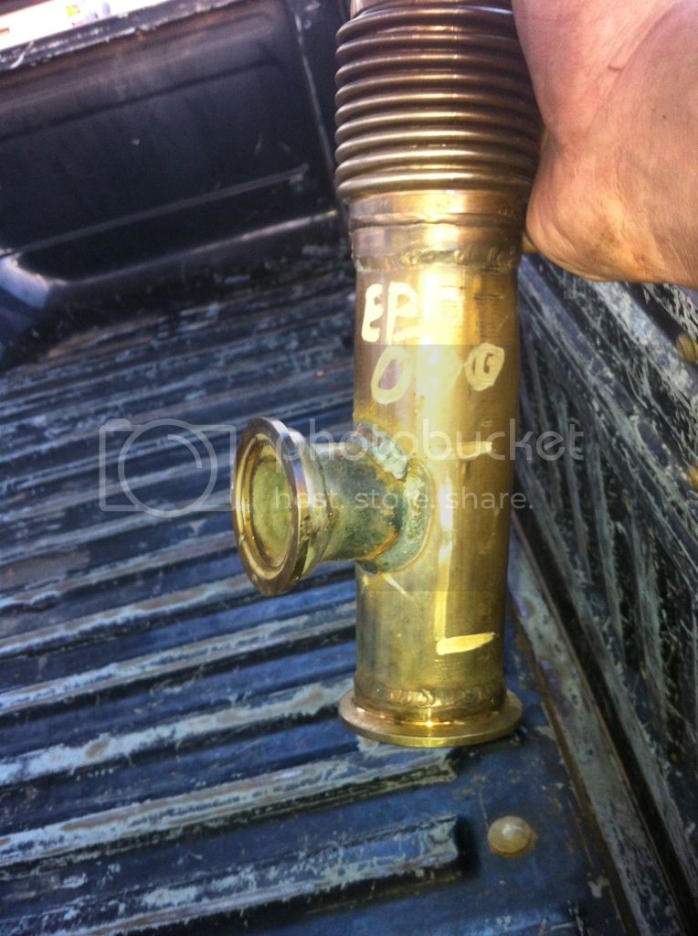

Got the rest of my parts in.
Hesston did the welding and fab work for me.
I have to purchase new cac boot and install wategate psi regulator in cab
Big thanks to my BRO Hesston blacksmoke73

I have 20psi of boost max the wastegate is opening up at 20psi with regulator closed regulator opened 40psi at ebp
