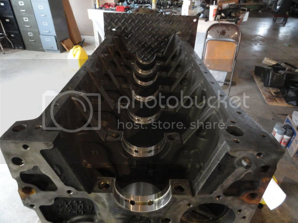

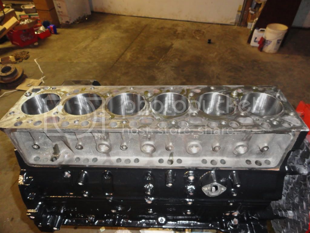

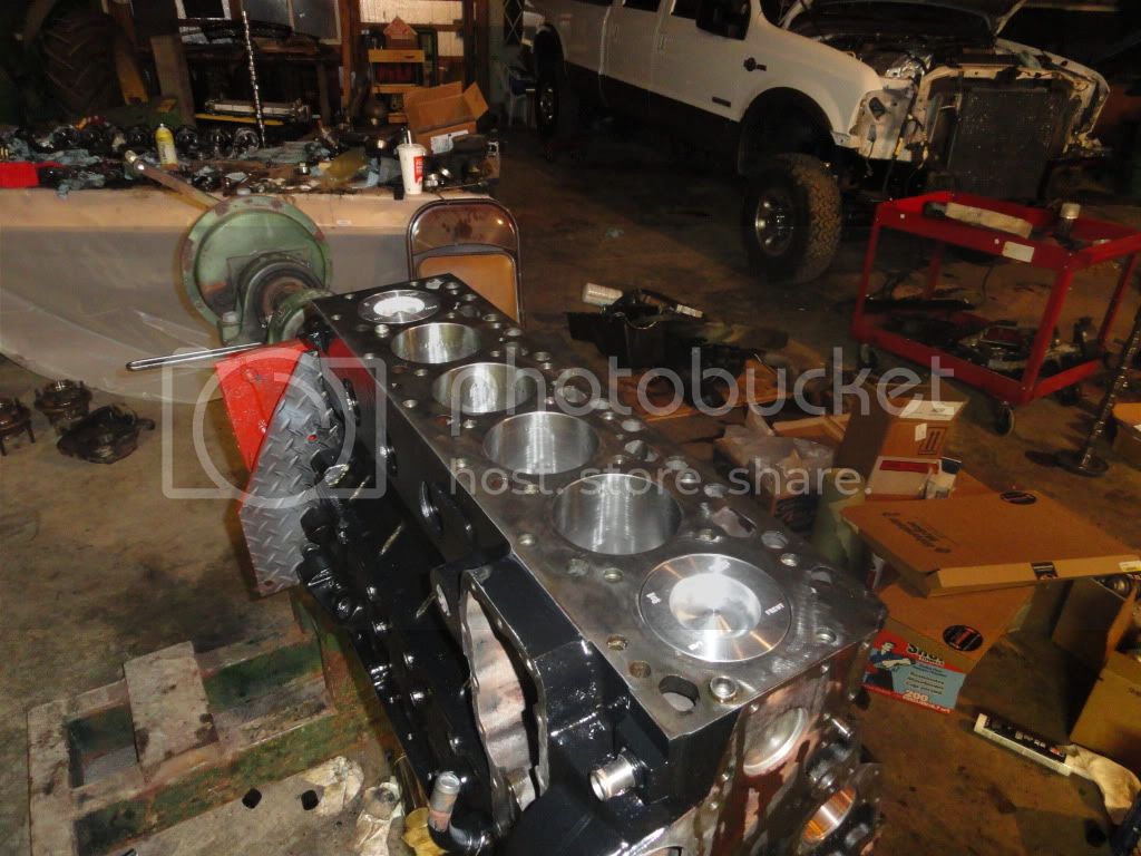

Got some good progress made today though, I finally got a good set of main and rod bearings straight from cummins and amazingly they all fit perfect! So today we got the bottom end all assembled.
All the clearances and crank end play checked were all in spec so needless to say I was pretty happy with how today went! Once I get my head back and my new front cover its time for the rest of the engine to go back together, now on to some pics:
Nice shiny new bearings:
Crank and main caps in:
Rods and shiny new pistons all in:

You need to clean up that garbage man. Gonna trip and lose a tooth.
Looking good Matt. And the truck is looking really lonely in the back ground.
Hotrodtractor
4,934
14
Mingo, Ohio
Trucks done exploded all over the shop. 6.0 and 5.9 parts everywhere from Matt, IFS and SAS stuff down through the "middle" with my truck, 7.3 PSD and associated parts just chillen and waiting for the block and heads to get done. LOL
