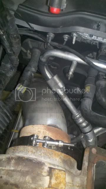

made a little more progress, got the downpipe amost done just need a vband and to finish welding the pipe, its a tight fit for sure but should work nice.

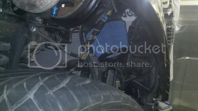

air filter is tight with the inner fender in, so im glad i got the filter i did
heres some pics

Looking good man. You going to wrap or ceramic coat the down pipe? Hopefully I get to see that system running when I am in the area..soon I hope.

Looks great D! Can't wait to see everything finished up and running. I think it's going to work great for you!

The down pipe is going to get wraped in header wrap for now, gotta see how everthing is going to play out, im also going to wrap the a/c line, and the wire harness with header wrap and then use some reflective tape, plus the harness is going to get tied up pretty far away from the down pipe so i think everything should work out well.

When you wrap the pipes and such put the header wrap in water first. Makes it stretch and then when it drys it doesn't come loose.
