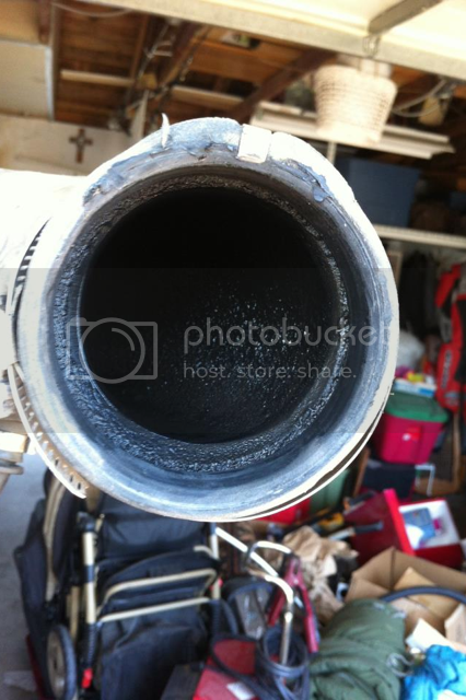

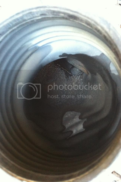

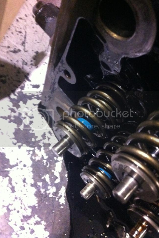

You can undo the lower IC boot to see if you have residual oil fron the crank case. It can also be a valve seal pushed out on the exhaust side but not likely if you just had it studded and heads replaced.
BFT
Moderator
2,628
southern cali
Intake filter side
Atmosphere turbo side
I had to clean the atmo turbo out real good because of all the gunk and build up. Pushed oil out of the seal on the "U" turbo to turbo pipe. CCV is vented to atmosphere, and everything is as clean as a whistle
My crank case has been vented since 40000 miles and my heads just had new valves and everything put in. My atmo charger is new so wen I get it back I'll check the bottom intercooler boot. It's just weird it started now with the new stuff on and never did this before.
