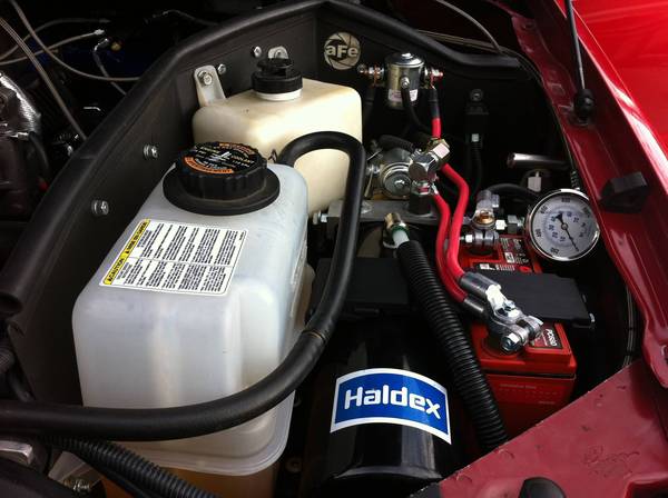

Need to get some ideas for mounting a custom/universal coolant tank setup I'm thinking for over around the brake master cylinder like on the 6.0's. Aluminum would be sweet.
Blowby
1,532
OBS tank mounted on the AFE intake compartment wall.
