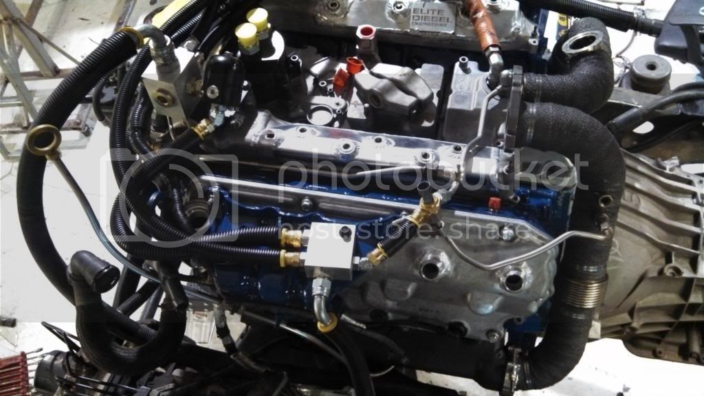

I should have a new CP3 installed today. Hopefully that is the issue. But I saw this pic and it raised some questions.
Should I be running my return like Erik?
Right now my return off the K16 and CP3 are T'd into each other and then sent back to the port on the side of the regulator. I saw his pic and was curious if I should be doing it that way?

By unplugging the CP3 rail pressure should rise dramatically at idle. But it just stays at 5k psi at idle which is normal. And driving with it unplugged would make it uncontrolled yet it runs normally like a single pump truck would.
Are you sure you have inlet and outlet of the cp3 correct?
Yes. Feed goes into the aluminum part and the return comes out next to the high pressure line.
