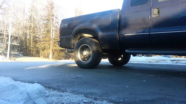

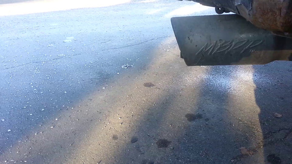

Mine looks about like Joes after first started at about 35... it will stay that way until I can get EGTs above 400.. Its got a tired GP or 3
CSIPSD
5,284
3
Bend, OR
I wish my 7.3s would start that clean above 50°.
live life full throttle
Thats about 30-35*...
Same here, but its worse now. I think its glow plugs for part of it, but it will have to wait until summer.

Yep. I figured it was that cold or colder. My 01 has a bad cylinder and the dually has always popped right off but it has always had a haze when below 50° on the first startup of the day.
