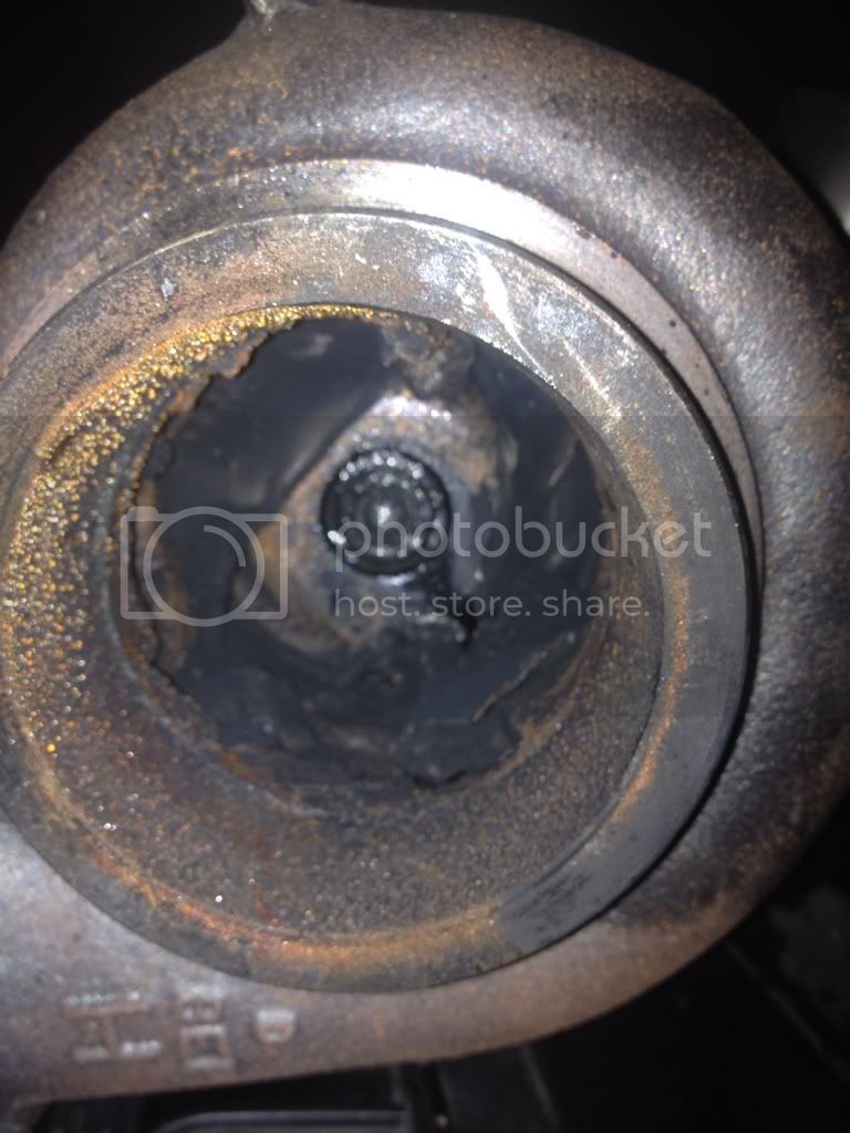

Bad news. The compressor side is chewed up. I'm calling bill tomorrow. I don't have time to yank the intercooler, not happy. Let alone of sh*t got into my

Temps were no more than 1000°, 20lbs of boost or less. Hadnt driven it hard all day...can anyone tell me HOW this happens, and has anyone seen seething like this before?

turbo wasn't balanced I'd bet. sorry this happened man...if i had another turbo laying around, i'd shoot it down to ya.

Thanks man I appreciate it. I just don't want them to not warranty it because it looks like a meltdown, when it wasnt! My powermax has been as hot as this!

It was definately a balancing issue. The turbine wheel could have been loose on the shaft too. ALWAYS check with the company your buying products from , it was on comp d and some tuner forms a while back about certain company's not balancing their chargers.
Morgan if you have any problems give me a shout. I have a few contacts on other companies for a new charger.Although I'm sure Matt will make things right.
For everyone's info Morgan sent me a few pics earlier today. Some companies used to require a restrictor in the oil feed, for some reason they thought limiting flow was a good idea. Last I heard that idea was tossed. Morgan's did not have a restrictor and was definately getting oil.

Usually the only turbos using a restrictor are ceramic ball bearing turbos like Turbonetics.
Your turbine wheel exploded...mine imploded a couple years ago while beta testing for a untrusted performance shop. (It literally pulled the housing in on itself, and spit it out the exhaust...along with parts of the turbine wheel.)
But even that company replaced my turbo, so you should be looked after for sure.

Well fellas. Bullseye came through. The wheel was defective. The engineer couldn't tell if anything hit the wheel causing it to fail. He said the wheels were balanced prior to assembly. Engineer said it was not overheated either. :thumbup: bill was very nice to deal with also, sometimes things happen with companies, and they stood behind their product.
Now, i may be Looking to move to a smaller turbo that has 2-3psi at 1500 instead of 1800Rpms: A precision 62/66/.83 ball bearing PT6266. Does anyone know if the precision turbos mount the same as a bullseye s300?
