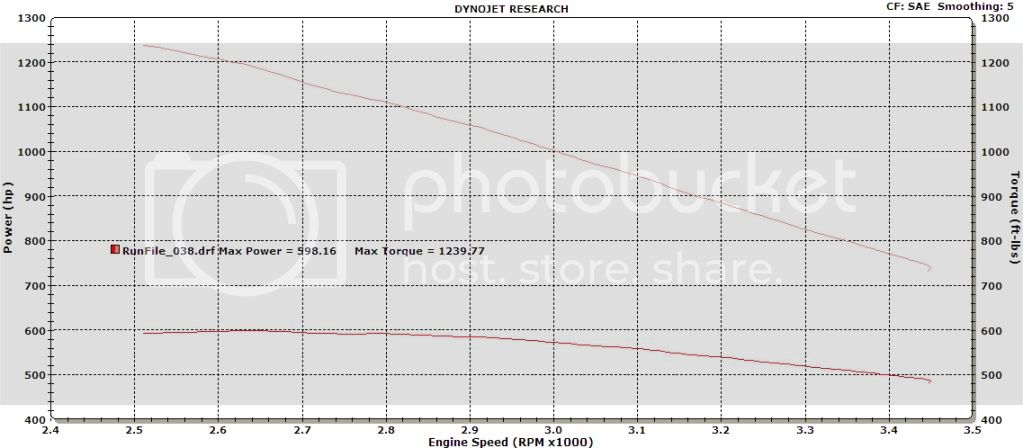

Dzchey21
11,784
wyoming
Here's a c
Graph from yesterday on an unloaded dyno

Back pressure on a stock motor is only around 60psi with a 600hp tune. Start adding injectors and different turbo setups and it can get into the 80-90 psi range with 6.0L manifolds. However I think the restriction is in the turbines of the turbos not the manifolds. I would like to try out a set of these though to see for myself.
