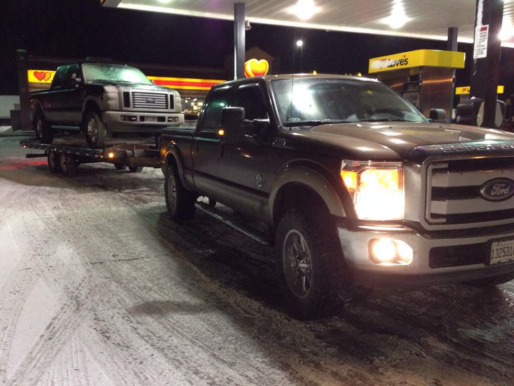

Well, I made it back. Just to give some merit to it I went to the scale and weighed (the fuel light was on) 21,360#. Ran into some bad weather
The weather made traffic a disaster around Chicago. Averaged 30mph for about a 100miles all down I-80, some of I-55 and I-94 was slow as well. Needless to say the stop and go I'm sure hurt mileage. But it averaged 10.9mpg at 21,360# so I am very pleased.
