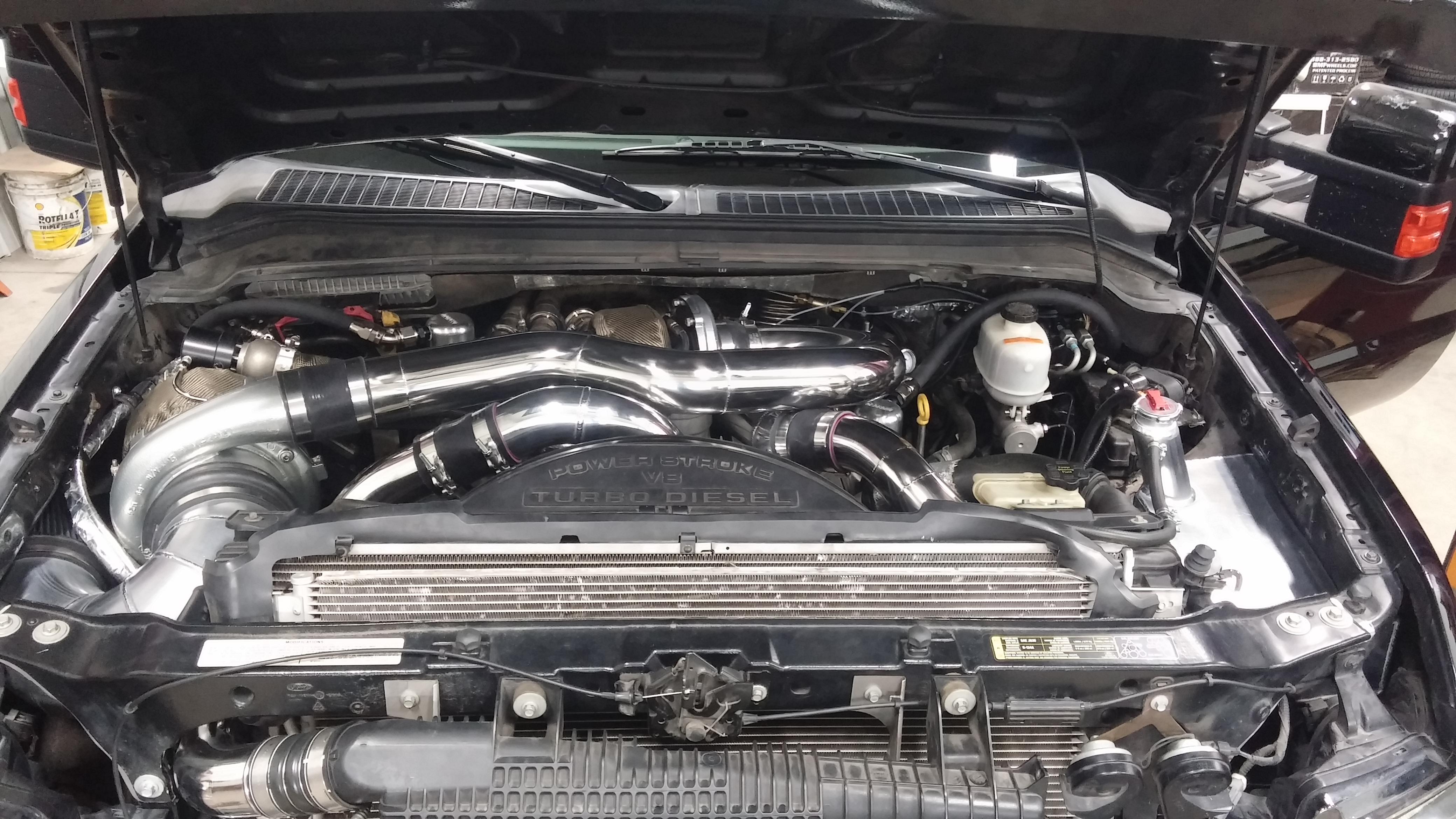

What ever someone decides, it shouldn't be because of the sounds its makes, or because its "different". I can tell you that probably no one in a 300 mile radius has a 6.4 that can touch mine, or has a set up like mine, so its different.... But thats not why I did it. I did it because its a street truck, and I wanted big, clean power and awesome spool up. They should make the decision on what they want to do with the truck and their budget.

Black Pearl. Im sure your set up is really clean and fun to drive, and I'm not sure what other trucks you've ridden in. But if you haven't ridden in a moderately sized compound truck, I'd urge you to.... You probably wont be saying that you'd do it the same way all over again....

Each set up has its advantages. I saved for 3 years to have what I have on my truck, and its still not where I want it. If these single kits were available back when I first bought my 08, who knows maybe I would've jumped on it since it was cheap and I wouldn't have had to wait so long to make good power. But after seeing videos of larger single set ups, and knowing how well mannered my truck is, and seeing Morgans truck with the 63mm making 10lbs just cruising, I wouldn't trade the drive-ability for a single,
especially the size single I'd need to make the same power I am right now.
